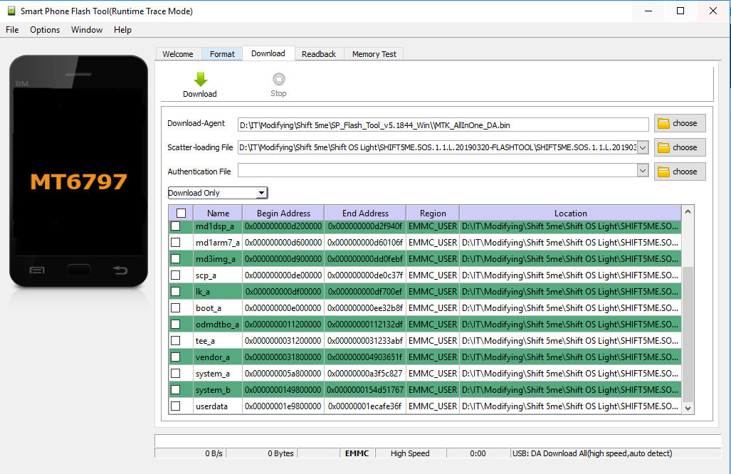

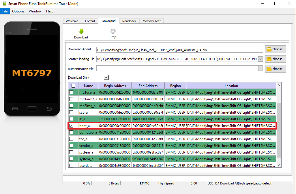

You open Flashtool. The file you have to choose is "MT6797_Android_scatter.txt"
Deselect all ticks.
By clicking on the path ("Location" column) in the "boot_a" line, a window opens again in which the patched file "boot.img" is opened. After selecting, only this line should be ticked.
By clicking on the green, downward-pointing arrow "Download", the Flash Tool goes into waiting mode.
Plugging in the switched-off Shiftphone starts the flash process.
Taken from here:
  1. Switch off the shiftphone
  2. Start the Flash Tool by double-clicking on "flash tool.exe".
  3. In the "Download" tab in the "Scatter -loading File" line, click on the folder symbol "choose" (far right) and navigate to the directory of the unzipped ShiftOS-FLASHTOOL package (the same folder from which the "boot-verified.img "was copied!)
  4. Open the text file "MT6797_Android_scatter". The flash tool now checks the files for correctness and shows the partitions and files that are flashed. Now all the check boxes are selected on the left.all boxes checked.PNG
  5. By clicking on the box below the drop-down menu, all boxes are deselected (empty boxes!)all boxes unchecked.PNG
  6. By clicking on the path ("Location" column) in the "boot_a" line, a window opens again in which the patched file "magisk_patched.img" is opened. After selecting, only this line should be ticked.boot_a checked only.PNG
  7. By clicking on the green, downward-pointing arrow "Download", the Flash Tool goes into waiting mode.
  8. Plugging in the switched-off Shiftphone starts the flash process.
  9. After that, the phone should start without any problems. In the Magisk Manager App there should now also be a green tick next to "Magisk".
  10. You now have ROOT access!

I have found that:
- I was using SP Flash Tool v6.x, I should have used the leatest v5.x, since v6 has no Scatter-loading File tab, and that was driving me a bit insane.
- I did as you said:
1. Selected MT6769_Android_scatter.txt as Scatter-loading File
2. Unchecked everything, leaving only boot_a and selecting the boot image you gently atteched
3. Download, then connected the shutfown Shift6m and voila it is done.
Then I turned on the smartphone, everything was working; then I used Root Checker to verify if I was rooted and my device was not rooted.
What am I missing?
Thank you
