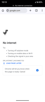

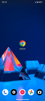

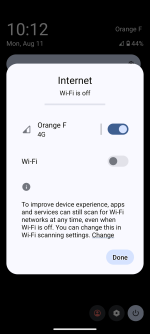

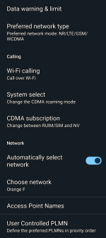

This is the problem I have when I'm not connected to Wi-Fi. no internet

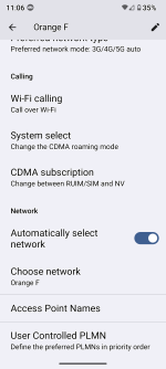

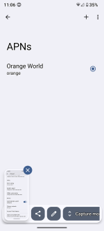

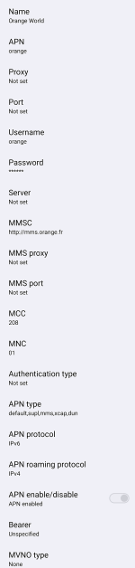

To be sure, can you please also post your APN Settings?
1) Settings -> Network and Internet -> SIMs -> Access point names
2) Please take a screenshot of the APNs listed there
3) Press on your selected APN used for internet to get to the "Edit access point" screen and take a screenshot there (you can press on "Capture more" to get the full screen in a single screenshot)
I have seen that we got some APNs for Orange F included, but maybe they are not up-to-date and I can diagnose better with having your current state of what is not working.
Then we can also contact Orange F to see what we are missing so that it does not work for you.
Here are my APN settings

I recently discovered that my mobile data works when I select "3G only," but when I choose "4G only" or "3G/4G/5G" (which is what I normally use), it doesn’t work.
Yes, my smartphone is up to date, and the APN settings are correctly configured. People living under the same roof as me are using the same operator, and their connections work fine. Even my previous smartphones, including one that’s almost 10 years old, were able to connect to 4G. However, with this Shiftphone, it’s now impossible to use 4G in areas where I could access it before.I hope this issue will be resolved soon.
1-The option to select “3G only,” “4G only,” or “3G/4G/5G” has disappeared, since the shiftOS 6.3 G update and mobile data still doesn’t work.
