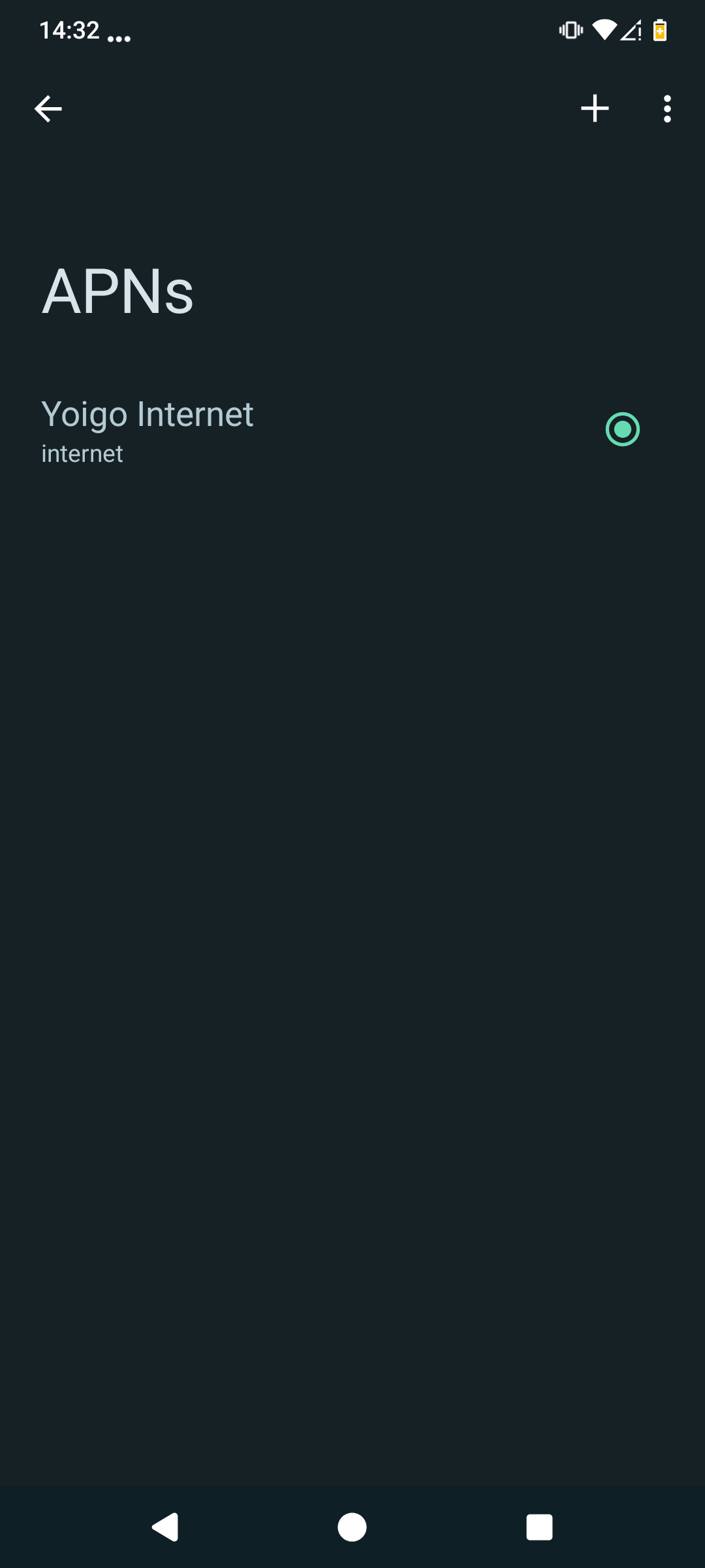

I suppose it could be something with the APN. Are the APN-settings correct? Or if so, it could be that the provider ‘certifies’ every single model from a particular manufacturer and blacklists all other devices (strangely enough, that’s what Swiss providers do; I’ve no idea what the point of it is).
apn should be fine, since it works for some time, then stops? I second the provider thing, I still think the best address is the shift support
Thank you both, I'm going to contact with the shift support. The APN-settings are ok because it use to work for three weeks. It's a mistery... XD

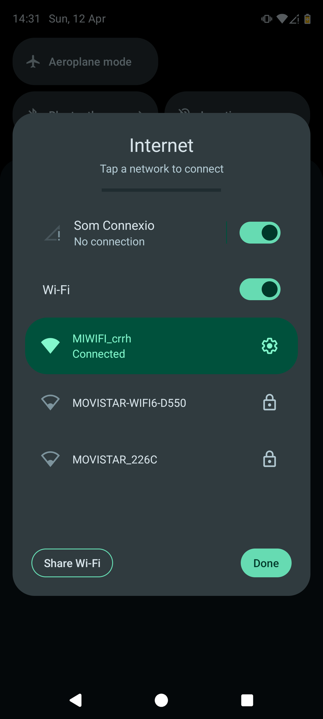

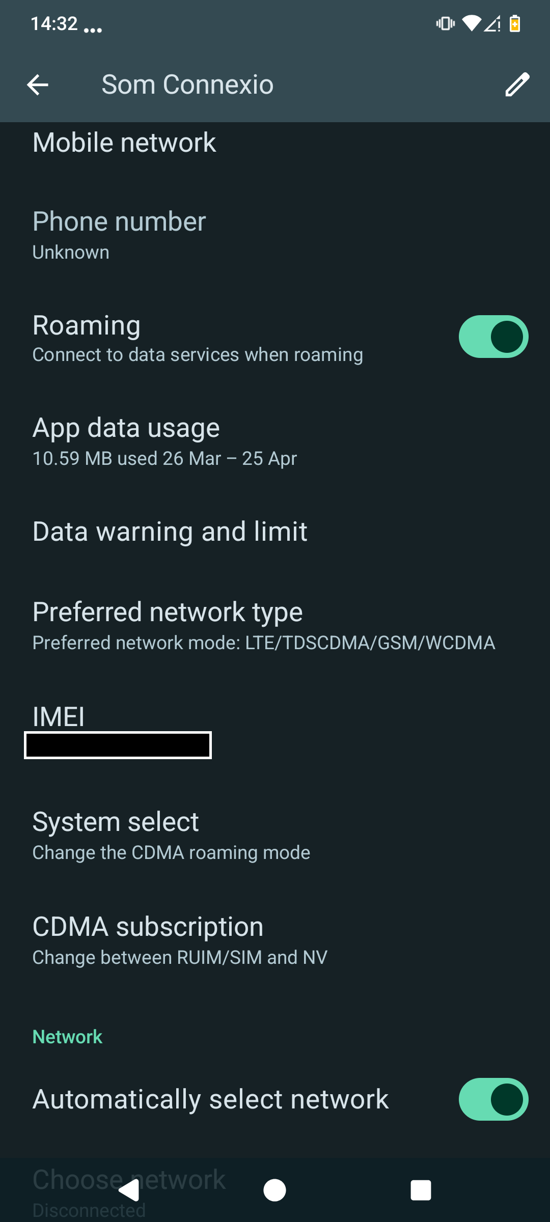

It recognises my company "Som Connexió", which operates through "Yoigo" (that is also ok in the APN). But it doesn't recognise my phone number (but I don't know if that's a problem).
