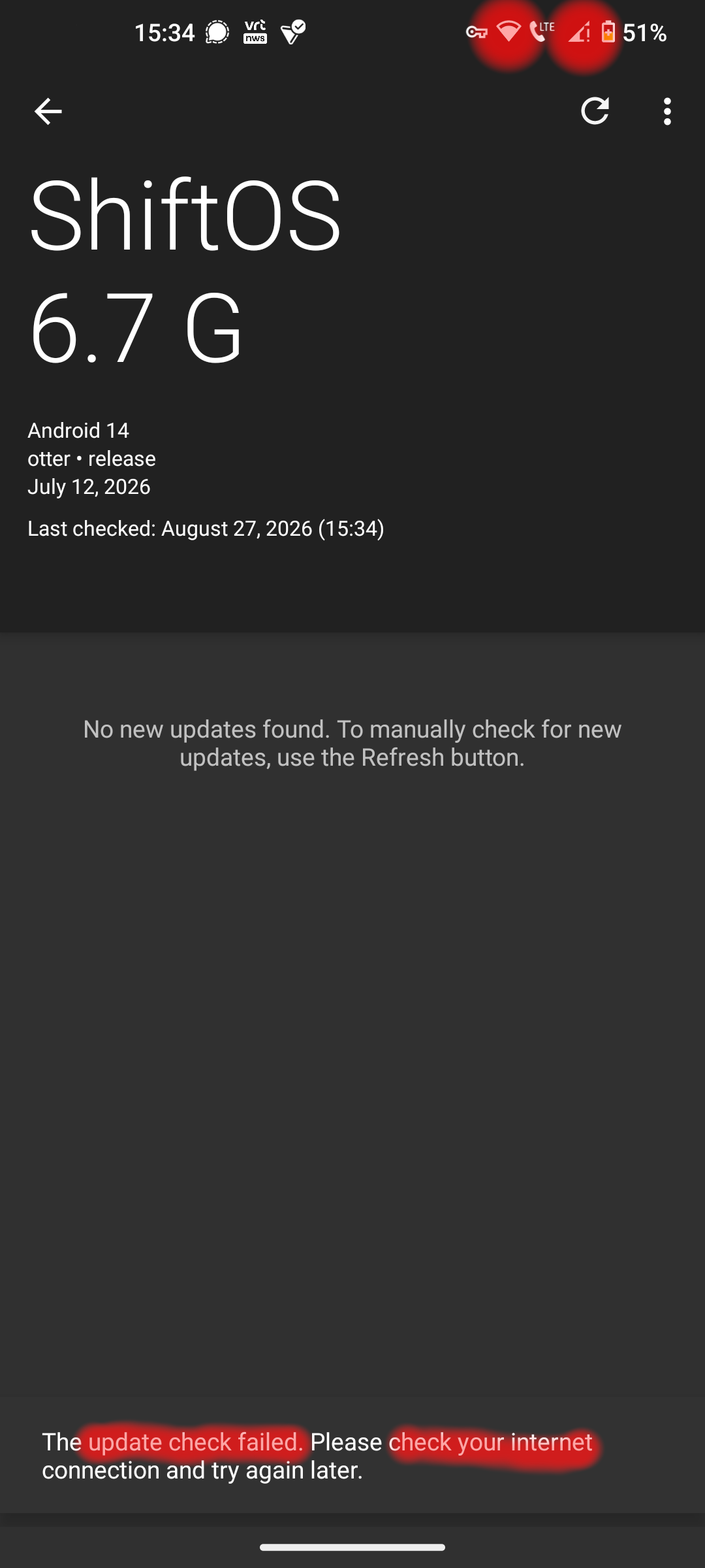

Yeah can't wait to see what the next update will bring... 😅(cfr. Image)

Yeah, indeed, I was shocked with the updates !
I was waiting for the first to see all what it would be brought ... nothing excepted small and non perceptible details (yes Im talking about details only !)
