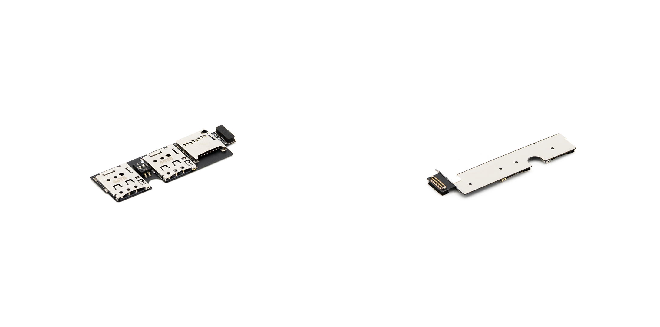

Hi, is it possible to change the microSD/SIM cards while the Shiftphone 8.1 is powered on via USB cable and without the battery in place?
If so, could I modify the plastic housing to allow the cards to be changed without removing the battery? They are on their own small module.

But there’s no hardware/electrical limitation here, right? May I ask, why you have intentionally blocked it in software? The phone does work without battery so ability removing cards seems reasonable.
There is no hardware limitation, at least none I am aware of.
It's just a switch in Android configuration files, which changes some behaviors.
We wanted to document the hardware state properly, so these configurations were entered "truthfully".
There also was not blocked something intentionally, because as far as I know these days most configs are ignored or just for visuals.
