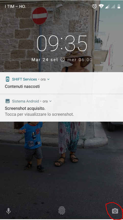

How to remove camera button from lock-screen?
peppinob
Sep 24, 2019
1
Gerät(e) / Device(s)
SHIFT6m
When my phone is locked in my bag, the camera can open up by itself, and it get really warm after a while. I couldn't figure out how to change this feature. Any help? thanks
