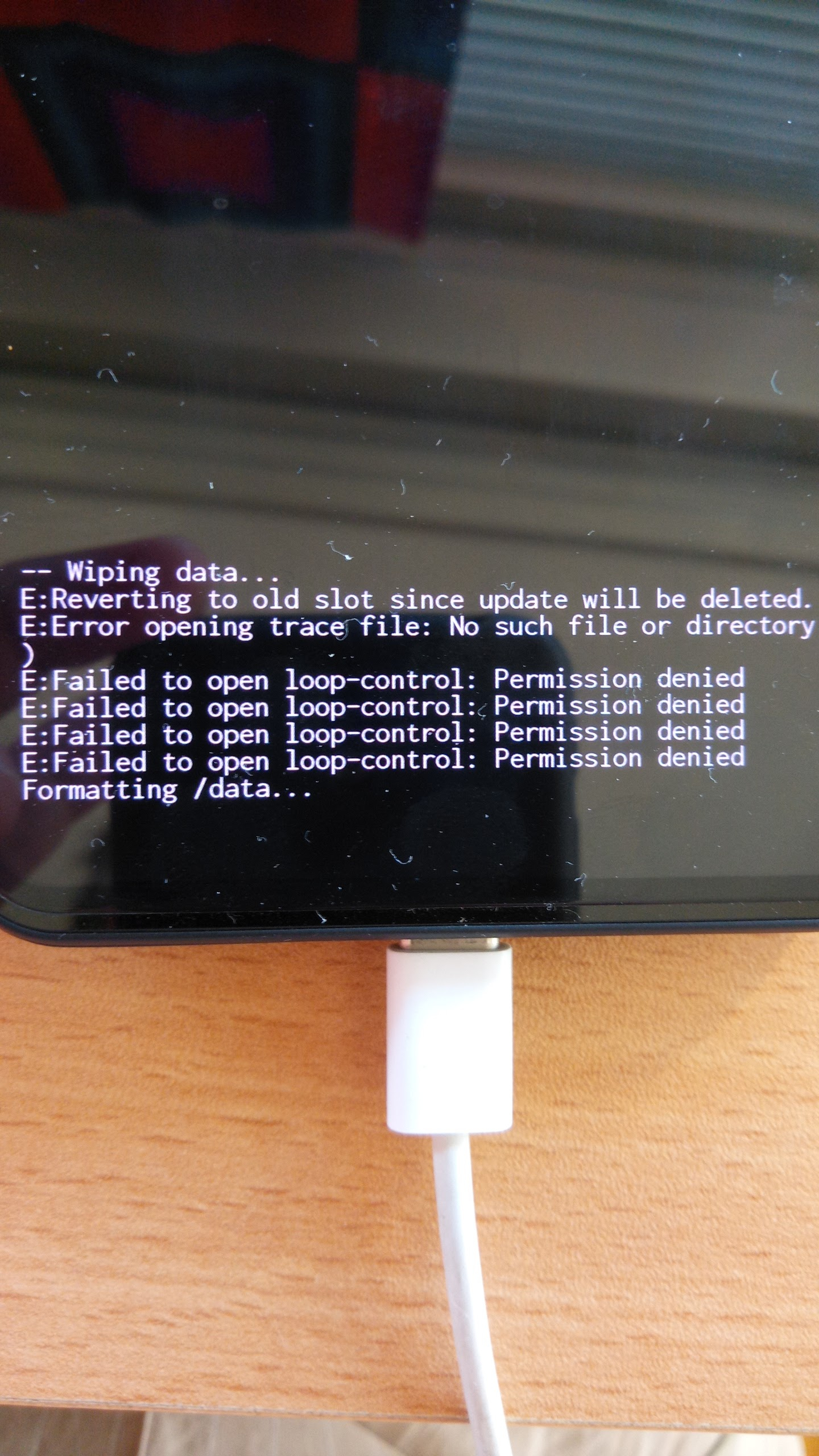

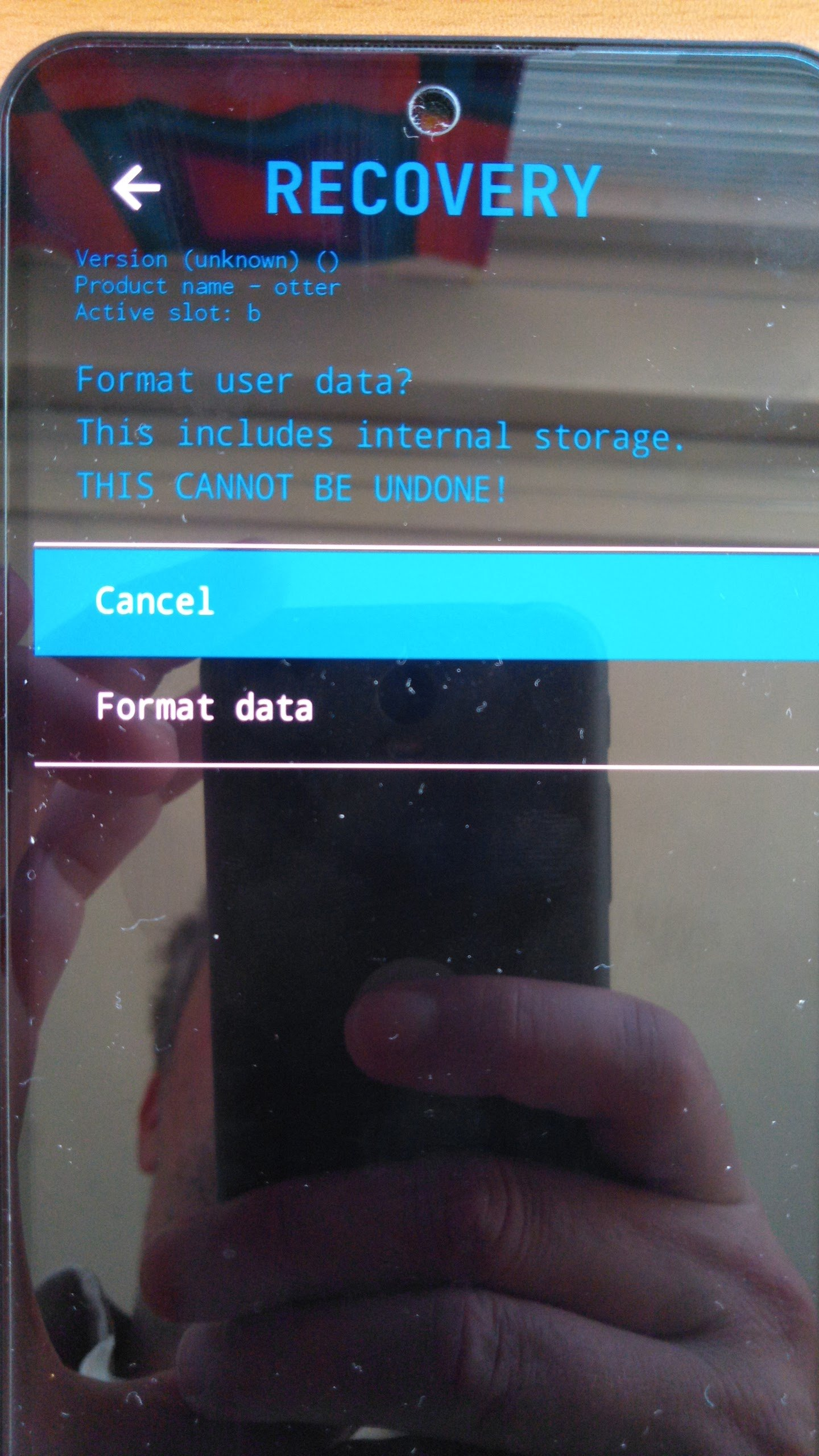

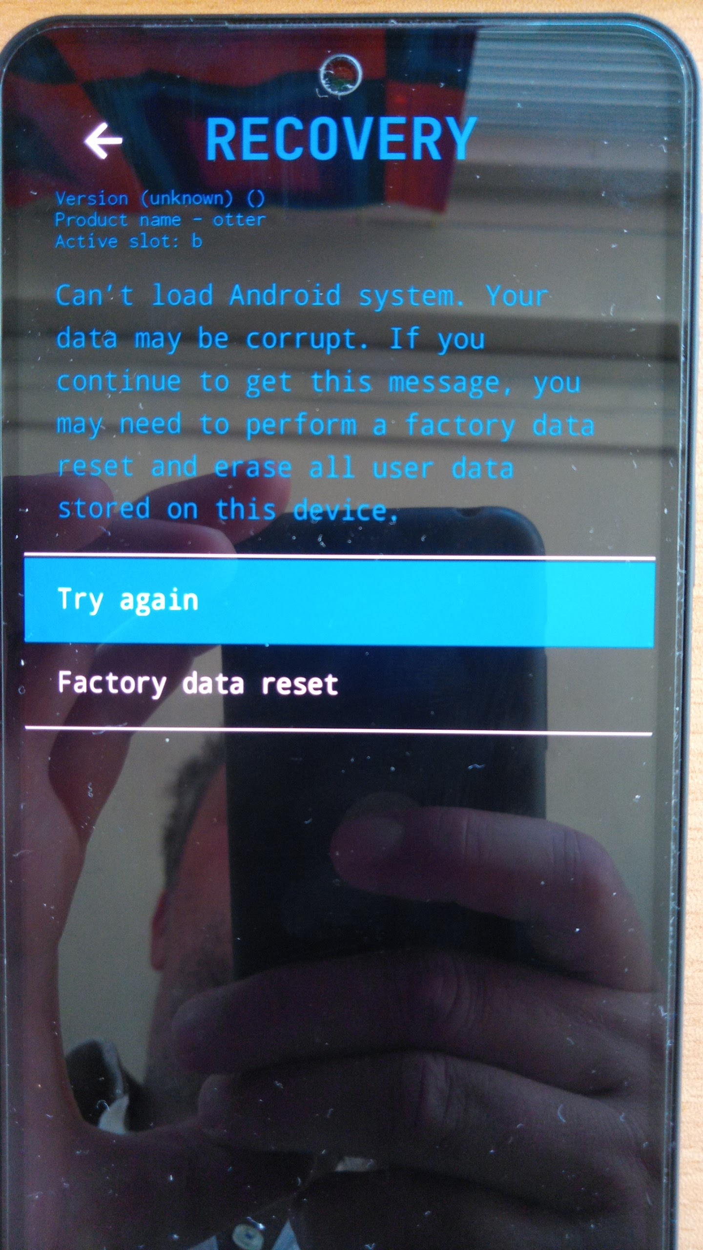

Hello
I have a shiftphone 8 with ShiftOS-L 7.1.
For professional reason I need to go back to ShiftOS G.
I have tried to install the ShiftOS 6.8 G with the file provided "OTTER. SOS.6.8.G-RELEASE-20260914-OTA.zip"
I have followed your instruction.
Downloading and installation worked good, then when doing the factory reset (before restarting as you warned) I have many error messages (see photo below), once restarted I see that the phone is still working with ShiftOS-L 7.1.
Any idea how to solve this issue ?
I would be very grateful
Many thanks
Vincent

Hello
Many thanks
Vincent
I have filled up a support request : Ticket : SHIFT#554029135
Could you try a factory reset after restarting?
I did it like 10 times yesterday, either way same trouble. first factory reset and second restart, or first restart and second factory reset, same result, the failed message during factory reset and the phone still working with shfitOS L 7.1. I can try it again now, just give me a few minutes to do it.
Ok I did it again, this time I've restarted when asked after installation is completed. The phone restarts, then shows the same message : "cant load Android system ... need factory reset". So I accepted the factory reset, and it shows the same message at bottom of screen
E: error opening trace file : no such file or directory
E: failed to open loop-control: Permission denied
Hello,
no success Yesterday trying factory reset both before and after restarting.
Same error failed to open loop control permission denied.
In your post you wrote that a Fastboot is an alternative option.
I don't trust my knowledge and skill to perform a Fastboot.
And since you warned that in case the phone does not reboot (bootloader locked) it need to be sent back to shift office for repair, I will not try a Fastboot.
So my only solution is the ShiftOS 6.8 G update to work.
(I have also try to install previous G update, the 6.7, 6.6, 6.5, but the files wont even load for installation)
Do you think there is any chance to have a answer and a solution in the coming days ?
(not weeks please :-((
Many thanks for your support
Vincent
Hello Vincent,
I'm not quite sure, what steps exactly you performed for installing Shift OS-G from Shift OS-L.
You mentioned
As far as I understood, it is not possible to use the "...-OTA.zip" to install an "older" version of the Shift OS. Since OS-G (Android 14) is always "older" than OS-L (Android 15), there is no way to install OS-G from OS-L by using the OTA (for now). You are obliged to use Fastboot with OTTER.SOS.6.8.G-RELEASE-20260914-FASTBOOT.tar.gz.
From that I don't know how
for you.
To help solving your issue, it might be helpful if you clarify your steps and used files in more detail.
However, I'm not an expert myself, but with the help of this thread (https://forum.shiftphones.com/threa...derherstellung-mittels-fastboot-paketen.5824/), I managed to install an "older" OS-L Version via Fastboot

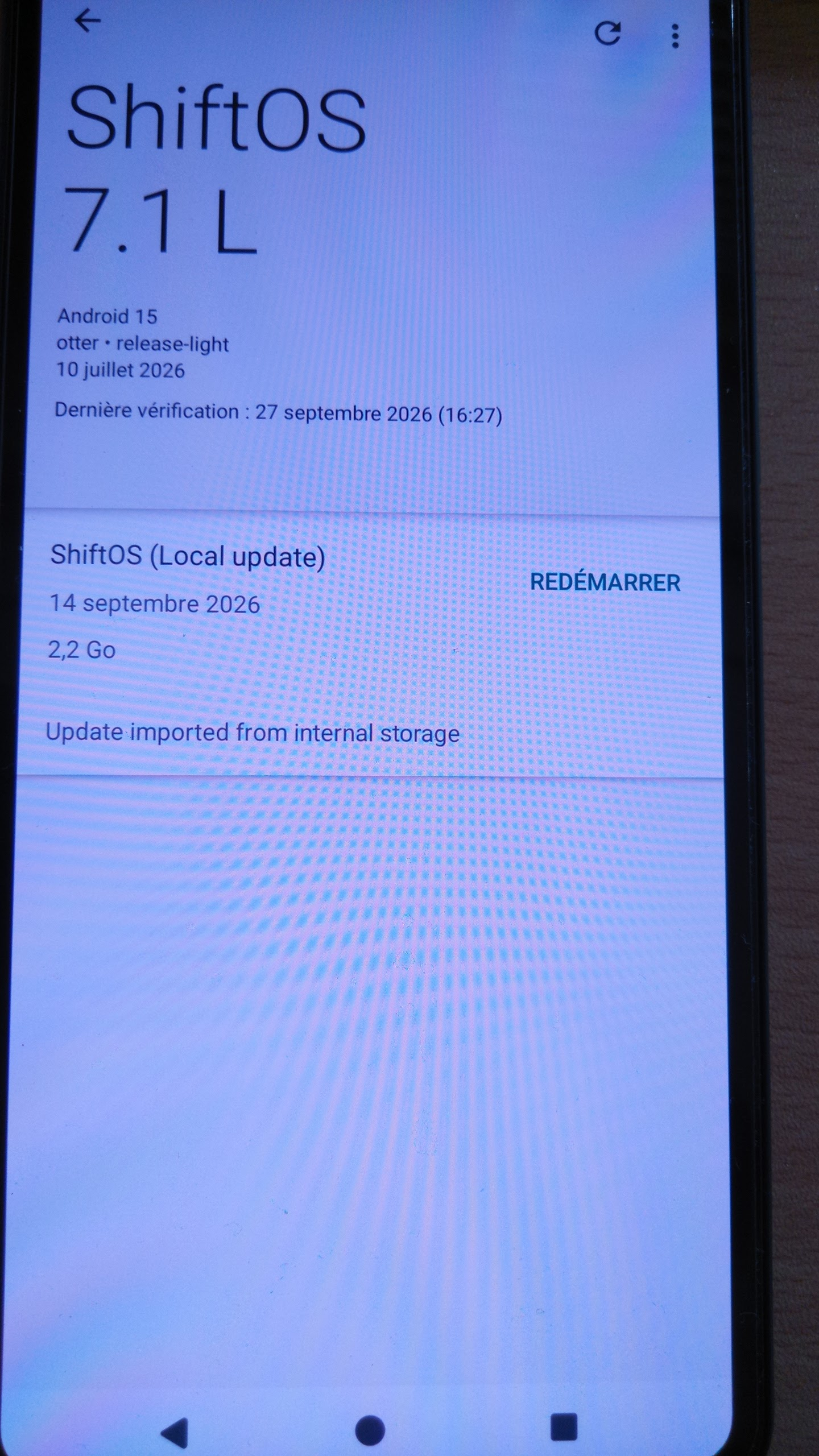

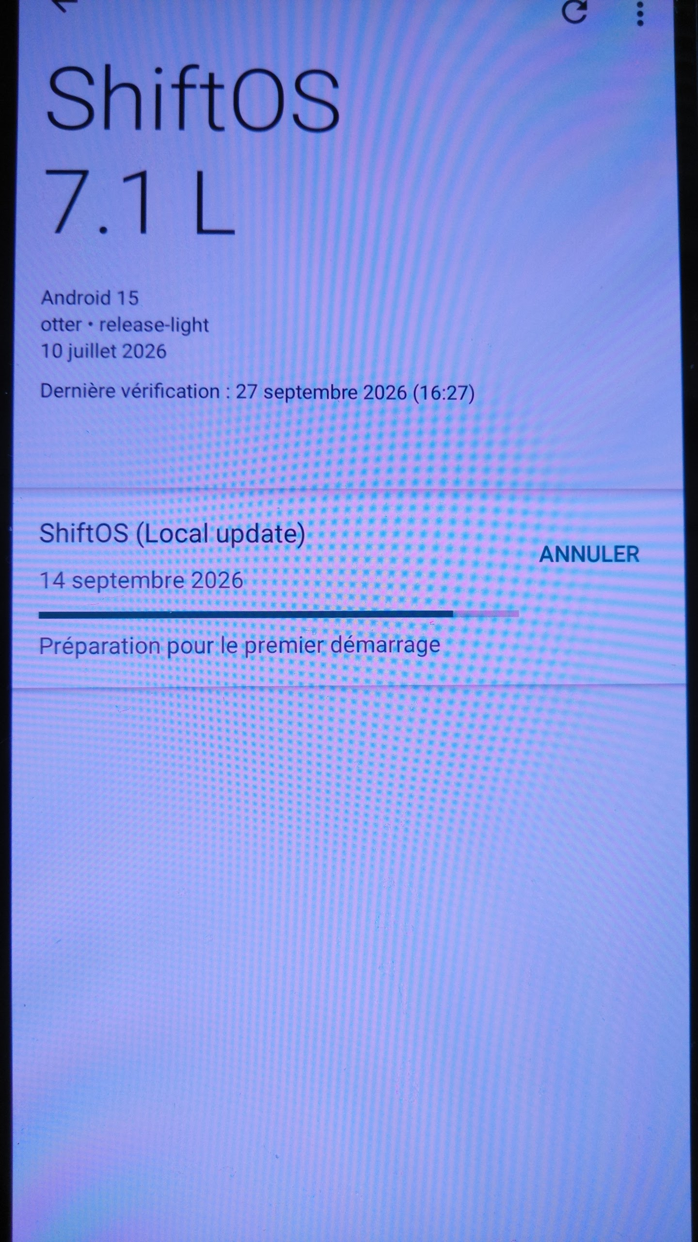

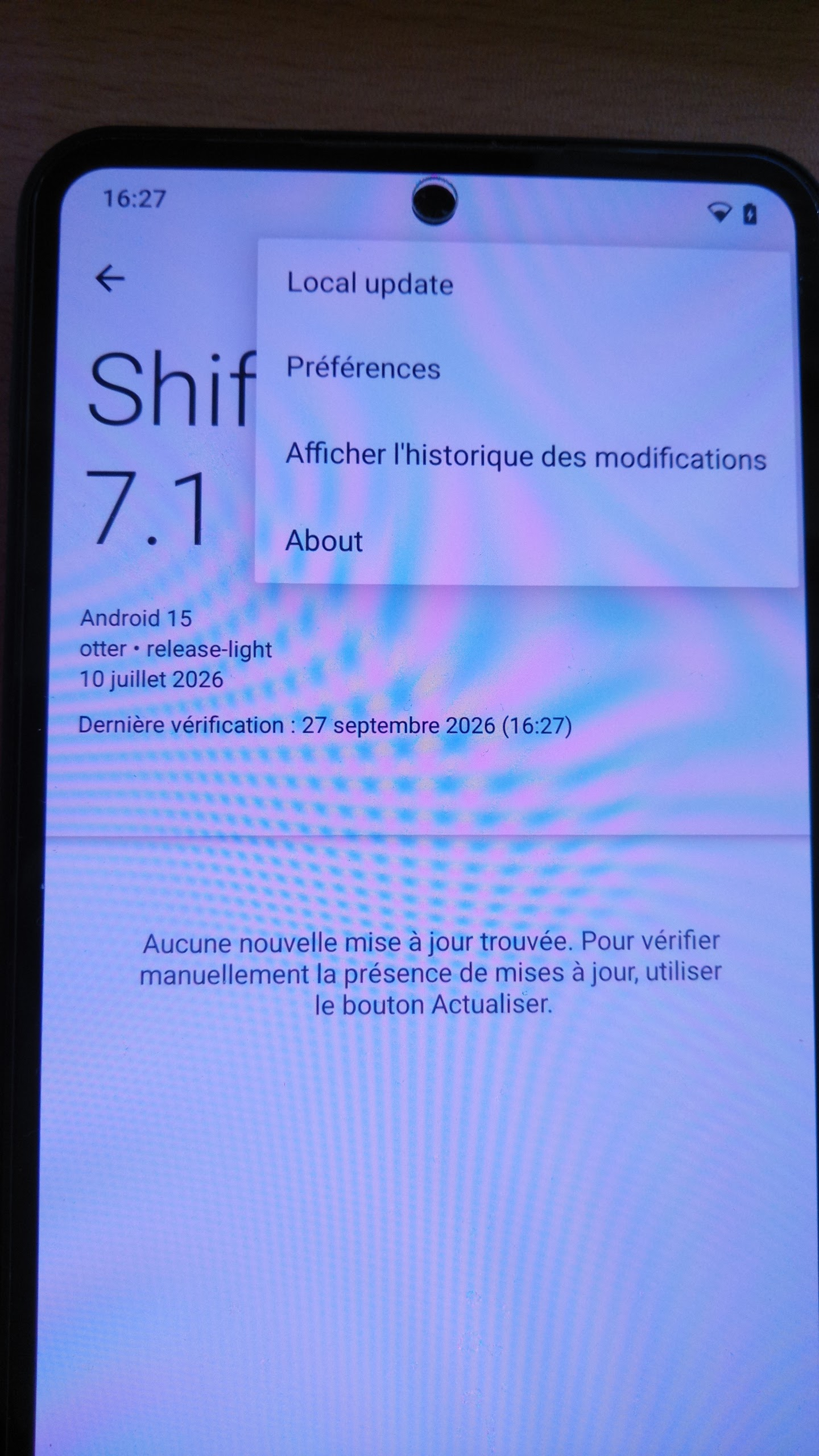

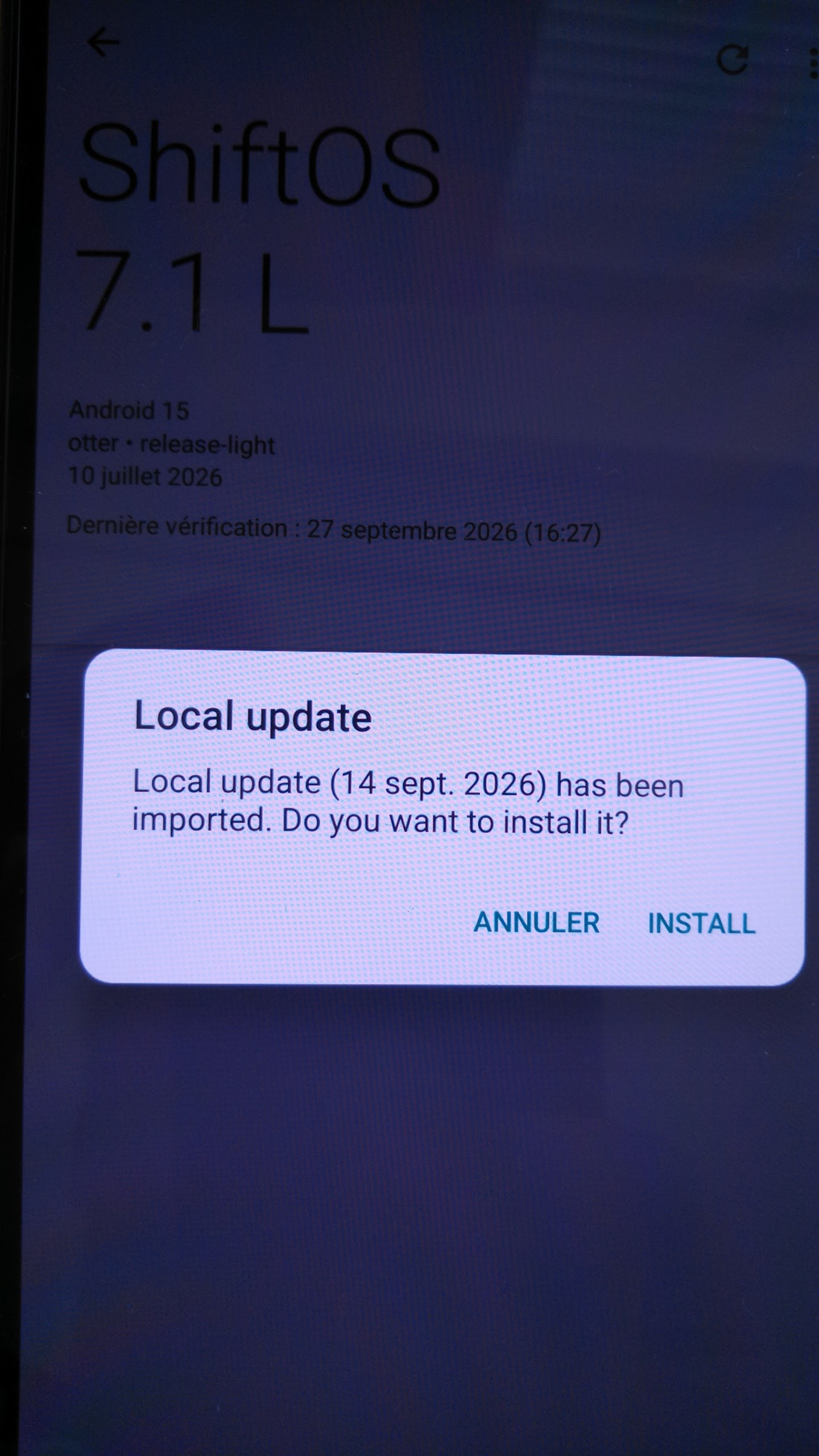

Dear Gernot
Thanks for your message.
I have download the file proposed at the beginning to this thread by Amartinz, the "OTTER.....OTTA.zip" file.
then click install the update form the "local update" option.
then installation worked fine.
The "OTTER.....OTTA.zip" file is found by the system, imported and installed
it is when asked for restart/reboot, and factory reset that it went wrong .
What you worte :
""As far as I understood, it is not possible to use the "...-OTA.zip" to install an "older" version of the Shift OS. Since OS-G (Android 14) is always "older" than OS-L (Android 15), there is no way to install OS-G from OS-L by using the OTA (for now). You are obliged to use Fastboot""
is exactly what I am afraid of :
impossible to us the OTA.zip, oblige to use Fastboot.
I am not a super geek expert myself, and I am afraid that if I mess up something I will have to send back my shiftphone 8 to Shift office / workshop in Germany. For them to perform a total reboot, as Amartinz warned at the beginning of the thread you share (which I read already and trigger my concern about performing a Fastboot on my own ):
If I failed to perform the Fastboot then I have to send the phone back to Germany . Which I would like to avoid
Anhang anzeigen 7483 Anhang anzeigen 7484 Anhang anzeigen 7489
Anhang anzeigen 7487 Anhang anzeigen 7488
What you worte :
If you follow the instructions (https://forum.shiftphones.com/threa...derherstellung-mittels-fastboot-paketen.5824/) exactly, you shouldn't have any problems. I tried it myself yesterday, and it went surprisingly well.
Just follow the instructions carefully and keep calm...
Good luck!
